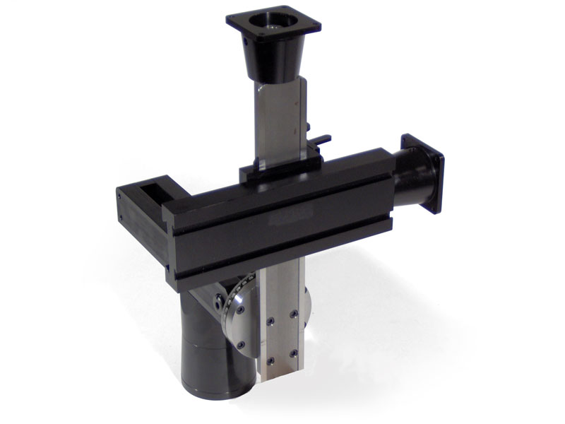

About the CNC-Ready 6-Direction, 2-Axis Machine Slide
  1. The slides are manufactured primarily from 6061-T6 aluminum and finished with a black anodizing. The slides that incorporate steel parts have ground dovetails.
  2. The table is 8″ x 2.75″, and any table is available with either an inch or metric leadscrew.
  3. The column is 11″ steel with ground dovetails with either an inch or metric leadscrew.
  4. Leadscrews are precision rolled from steel, and table screws are located under the table, out of the way of chips. Leadscrew backlash is adjustable.
  5. Dovetailed tables and saddles have adjustable gibs to eliminate play.
  6. Travel includes X- and Z-axis movements by handwheel, plus manual ram control for the column rotation, pivot, swing, and in/out travel.
  7. 1-5/8″ Industrial handwheels are graduated in .001″ increments on inch slides and in .01 mm increments on metric slides.
  8. Stepper motor mounts for NEMA 23 stepper motors
NOTE: CNC-ready slides cannot be operated manually until stepper motors are installed.
