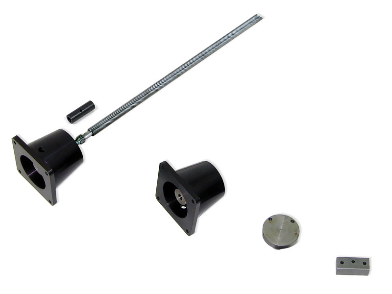

Any existing Sherline lathe can be converted to CNC-ready status. The installation will involve drilling and tapping several holes to attach the stepper motor mounts. The kits include drill blocks that are attached to the appropriate table or bed using the single existing hole, and then two new holes are drilled using the block as a guide. The holes are tapped, and the new mount is installed. In the case of the lathe leadscrew, a new leadscrew must also be installed. Complete instructions for the conversion are supplied with the kits.

The complete upgrade kit for the Lathe includes:
  • 2 Stepper Motor Mounts
  • CNC-RH Coupling Preload Nut
  • CNC-LH Coupling Preload Nut
  • CNC Lathe Bed Leadscrew
  • CNC Lathe Leadscrew Thrust
  • 4 Stepper Motor Preload Bearings
  • 2 CNC Couplings
  • CNC Template, Bed Bushing
  • CNC Template, Slide Bushing
  • Screws for Motor Mount Attachment
