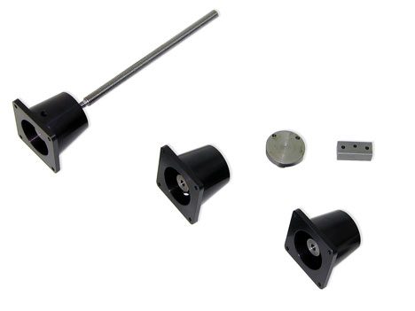

Any existing Sherline vertical mill can be converted to CNC-ready status. The installation will involve drilling and tapping several holes to attach the stepper motor mounts. The kits include drill blocks that are attached to the appropriate table or bed using the single existing hole, and then two new holes are drilled using the block as a guide. The holes are tapped, and the new mount is installed. In the case of the mill column, a new leadscrew must also be installed. Complete instructions for the conversion are supplied with the kits.

The complete upgrade kit for the Mill includes:
  • 3 Stepper Motor Mounts
  • CNC  Z-axis Screw
  • 2 CNC-RH Coupling Preload Nuts
  • CNC-LH Coupling Preload Nut
  • 6 Stepper Motor Preload Bearings
  • 3 CNC Couplings
  • CNC Template, Bed Bushing
  • CNC Template, Slide Bushing
  • Screws for Motor Mount Attachment
