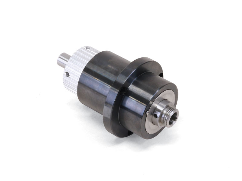

About the Industrial Flanged Cartridge Spindles
The cartridge spindle bodies are turned from bar stock steel and have a black oxide finish. The steel spindle shaft has a .405″ (10mm) hole through the center. They are available with your choice of a spindle (3/4-16 #1M taper or an ER-16*) and pulley configuration (a standard 2-step “V” belt pulley or a 30-tooth cog belt pulley).
Standard Features
  • 3 mounting holes at 120° increments are 0.2″ diameter with a 0.325″ diameter countersink and are sized for 10-32 x 5/8″ socket head cap screws (supplied)
Installing the Flanged Cartridge Spindle
The Sherline flanged cartridge spindle has a 2.25″ diameter body and was designed to be mounted through a hole of 2.3″. It is attached using the three holes provided in the 3.1″ diameter flange. The holes are on a 2.676″ diameter bolt circle at 120° increments around the flanged diameter. The mounting holes are 0.2″ in diameter with a 0.325″ diameter countersink and are sized for 10-32 x 5/8″ socket head cap screws (supplied). The face of the spindle extends 1.0″ beyond the front surface of the flange.
Optional Nickel/Teflon Spindles
Most of our spindles are available with a Nickle/Teflon plating as a rustproof option for an additional cost. Check the option box above to add the Nickel/Teflon plating to your spindle order.
Spindle Precautions
Download PDF Industrial Flanged Cartridge Spindle Instructions
Spindle diameter:2.250″ (57.15 mm)
Spindle body length:3.0″ (76.2 mm)
Spindle nose thread (Models 6505, 6506)3/4-16
Spindle nose internal taper (Models 6505, 6506)#1 Morse
Spindle nose thread and taper (Models 6507, 6508)ER-16
Bearings(2) 20 mm, class 5, lifetime lubricated ball bearings with adjustable preload
End play (factory preload adjustment).0002″ (.0051 mm)
Maximum spindle speed10,000 RPM
Recommended continuous spindle speed4000 RPM or less
Mounting provision3 mounting holes at 120° increments are 0.2″ diameter with a 0.325″ diameter countersink and are sized for 10-32 x 5/8″ socket head cap screws (supplied)
