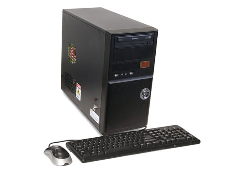

LinuxCNC Computer System with Driver Box
- Built-in Driver box (Converts g-code to steps to run DC stepper motors)
- Output cables for X, Y, Z, and A pre-wired with DIN plugs for stepper motors
- Keyboard and mouse (you supply the monitor)
- Processor Speed: 2 GHz or faster
- RAM: 2 GB
- Hard Drive: 500 GB
- Internal drive: DVD-RW
- External drive: 4 GB USB Flash drive for transferring g-code files
- Current: Internal switches are set to 110VAC but can be reset for operation with 230 VAC
- Installed software: Ubuntu 12.04 Linux-based OS with Linux CNC 2.6.11 4-axis CNC software.
- 90-day warranty on CNC and computer-related components.
