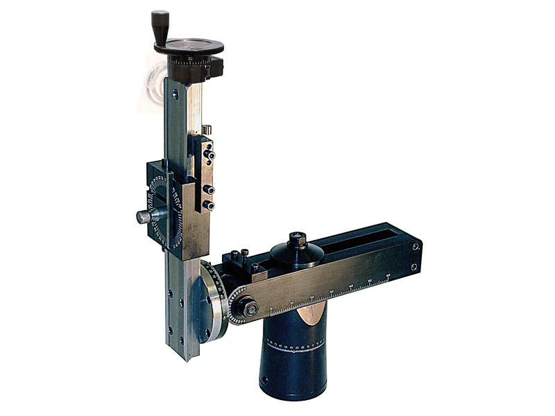

Multi-Direction Mill Column – DRO
34060 | Thrust Bearing Set | 1 |
35160 | Graduated Clamping Ring | 1 |
35170 | Movable Clamp Disk | 1 |
40175 41175 | Saddle Locking Lever (Inch) Saddle Locking Lever (Metric) | 1 |
40176 | Saddle Travel Extension w/Screws | 1 |
40177OL 41177OL | Saddle Nut with Oiler (Inch) Saddle Nut with Oiler (Metric) | 1 |
40260 | Head Key | 1 |
40330 | 10-32 x 5/8″ SHCS | 4 |
40340 | 10-32 x 1″ SHCS | 1 |
40600 | 10-32 x 1/4″ Flat Point Set Screw | 1 |
40660 | #10 Washer 3/16″ | 1 |
40670 | 10-32 x 1/2″ SHCS | 4 |
40690 | 10-32 x 3/4″ SHCS | 4 |
40740 | 10-32 x 7/8″ SHCS | 1 |
40820 | Gib Lock | 1 |
40900 | 10-32 x 3/8″ Flat Head Screw | 1 |
40990 | Saddle Gib | 1 |
45011 45161 | Column Lead Screw (Inch) Column Lead Screw (Metric) | 1 |
45030 | Column Bed | 1 |
45040 | Column Saddle | 1 |
50211 | 8-32 x 1/4″ Button Socket Screw | 1 |
50220 | 1/4-20 x 1-3/4″ SHCS | 2 |
50240 | Pivot Pin | 1 |
56130 | Arm Hold Down Bolt | 1 |
56200 | Arm Hold Down Washer | 1 |
56210 | 3/8-16 x 2″ Should Bolt | 1 |
56220 | Swing Arm – Left Side | 1 |
56230 | 3/8-16 Flange Nut | 2 |
56240 | 1/4-20 x 1-1/2″ SHCS | 2 |
56330 | Swing Arm – Right Side | 1 |
56350 | Column Adjustment Block | 1 |
56400 | Arm Spacer Block | 1 |
56440 | Arm Mount | 1 |
56450 | Index Tab | 1 |
56470 | 3/32″ x 1/2″ Dowel Pin | 1 |
56550 | Column Top | 1 |
56700 | Mill Column Base | 1 |
76140 | 5/64″ Hex Key | 1 |
81100 | Encoder Unit with Cable | 1 |
81340 81342 | 2.5″ Z Axis DRO Handwheel (Inch) 2.5″ Z Axis DRO Handwheel (Metric) | 1 |
81350 | DRO Z Axis Thrust Collar | 1 |
