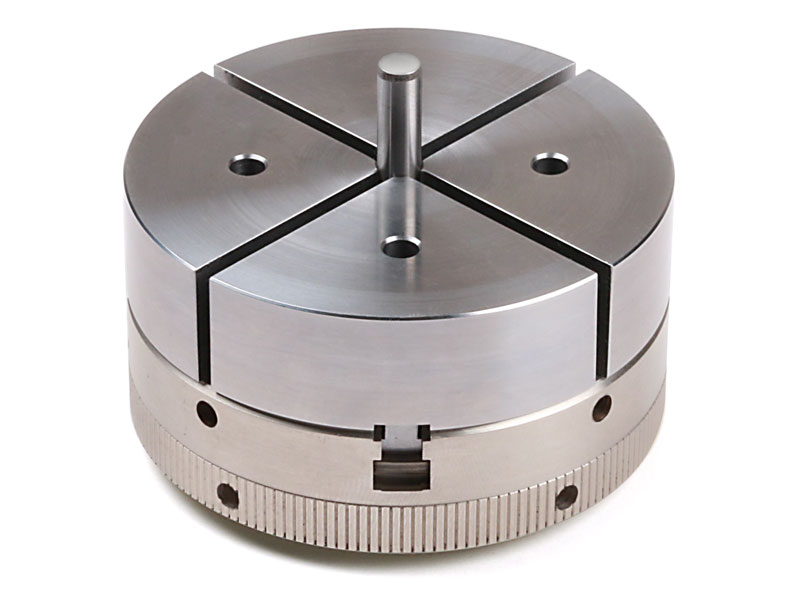

3.1″ 4-Jaw Chuck with Pie Jaws
Includes a steel dowel pin, hex key, and 2 tommy bars, not pictured.

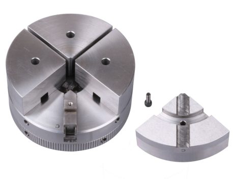

Included with the chuck and jaws:
  • 1 1/4″ x 1″ steel dowel pin that is used to adjust the jaws during installation and to chuck up on while boring and turning the jaws
  • 1 1/8″ hex key for tightening the 4-40 x 3/8″ jaw mounting screws
  • 2 spindle or “Tommy” bars for loosening and tightening the chuck

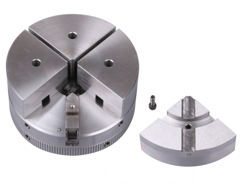

Because the jaws are meant to be bored to size for particular jobs, eventually they will need to be replaced. The replacement set P/N 1143-4P can be installed on your existing 1076C Nickel-Teflon coated chuck body and master jaws. They are NOT intended for use on the standard 1076 chuck body.
NOTE: These jaws are designed to be used ONLY on our Nickel-Teflon coated chuck P/N 1076C, and master jaws are custom fitted to each body, so master jaws (11445-P) are not available for purchase separately.
Why pie-shaped jaws?
First developed by watch and clock makers, chucks with pie-shaped jaws offer two main advantages. Boring the unhardened jaws to hold a particular diameter part means that instead of gripping the part at only three or four tiny contact points, they grip the part all the way around its diameter. This increased gripping area allows for much less clamping pressure and less chance of deforming a gear or other delicate part held in the chuck. In addition, because the face is bored to an exact and consistent depth, placing additional parts in the chuck for turning or milling means each part surface is held at exactly the same depth as the previous parts, saving setup time.

*Because chuck master jaws are factory ground to precisely match each chuck body you must send your chuck back to us to be fitted with new master jaws. Please contact us for instructions on how to return your chuck.
