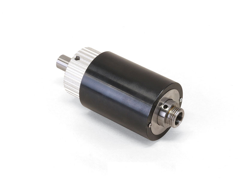

About the Industrial Round Cartridge Spindles
The cartridge spindle bodies are turned from bar stock steel and have a black oxide finish. The steel spindle shaft has a .405″ (10mm) hole through the center. They are available with your choice of a spindle (3/4-16 #1M taper or an ER-16*) and pulley configuration (a standard 2-step “V” belt pulley or a 30-tooth cog belt pulley).

The Sherline round cartridge spindle has an OD of 2.2495″–2.2500″ on the cartridge. This cartridge is designed to be mounted in a 2.250″–2.252″ diameter hole.

Spindle diameter:2.250″ (57.15 mm)
Spindle body length:3.0″ (76.2 mm)
Spindle nose thread (Models 6509, 6510)3/4-16
Spindle nose internal taper (Models 6509, 6510)#1 Morse
Spindle nose thread and taper (Models 6511, 6512)ER-16
Bearings(2) 20 mm, class 5, lifetime lubricated ball bearings with adjustable preload
End play (factory preload adjustment).0002″ (.0051 mm)
Maximum spindle speed10,000 RPM
Recommended continuous spindle speed4000 RPM or less
Mounting provisionNone. This cartridge is designed to be mounted in a 2.250″–2.251″ diameter hole.
