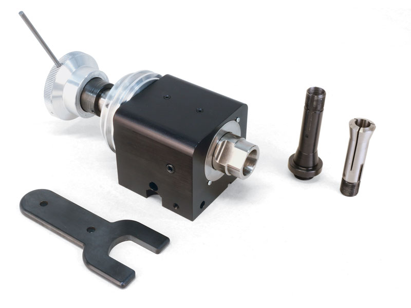

Sherline 3C Collet Spindle Headstocks
Includes 1″ spindle wrench and spindle bar (chuck arbor and collet not included, shown for reference only)

About Sherline’s 3C Collet Spindle Headstock
Our 3C Collet Headstock came from customers’ requests. Many customers asked for a spindle and collet to allow larger diameter stock to go through the headstock. With the 3C collet, our customers can now hold stock up to 1/2″ diameter that will pass through the headstock.
The 3C Collet Headstock is interchangeable with our standard headstock. The centerline height is the same, and the mounting system is the same. Therefore you can easily switch from our other headstocks to the 3C headstock.
The 3C Spindle is electroless nickel plated to aid in rust prevention and increase the spindle’s surface hardness for durability. The headstock includes a spindle pulley and a precision ground head key.
If you wish to use a chuck with the 3C headstock, you can purchase the 3C to ¾-16 chuck arbor. All of our 3- and 4-jaw chucks with a ¾-16 thread will fit on this arbor.
