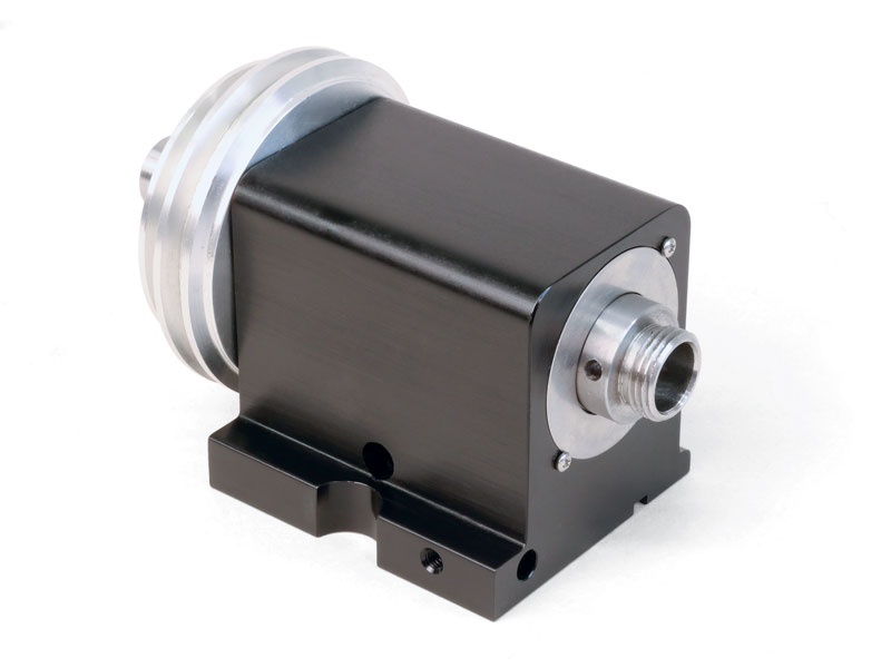

About Sherline’s 9/16″ Through-Hole Spindle Headstock
We opened the spindle through-hole to a maximum of 9/16″ (14.28 mm). While this allows larger stock to pass through the headstock, it also eliminates the #1 Morse internal taper, meaning tapered tools like drill chucks, fly cutters, etc., cannot be held in the headstock. Threaded tools can still be used, such as 3 or 4-jaw chucks and end mill holders. The headstock includes a spindle pulley and a precision ground head key.
