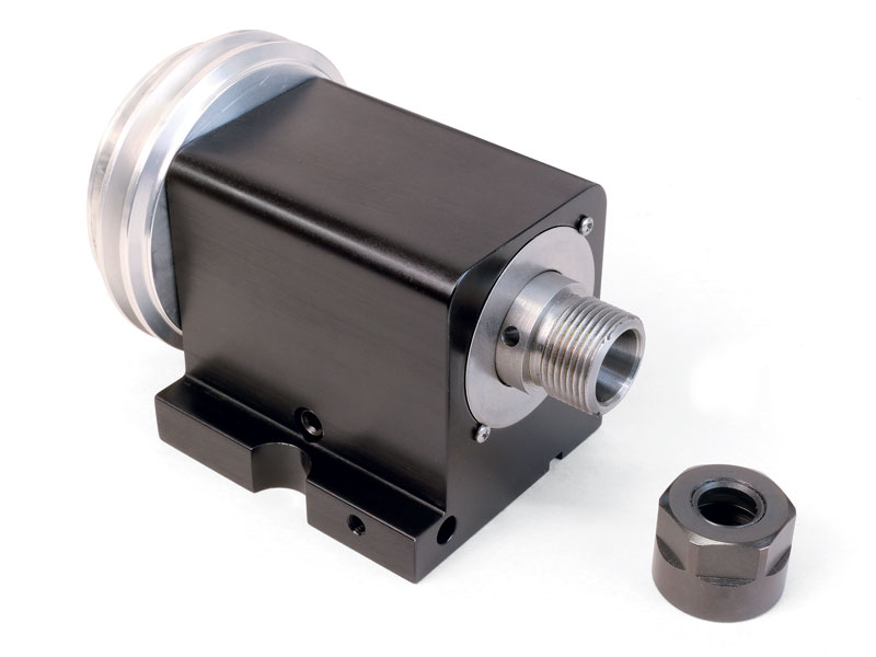

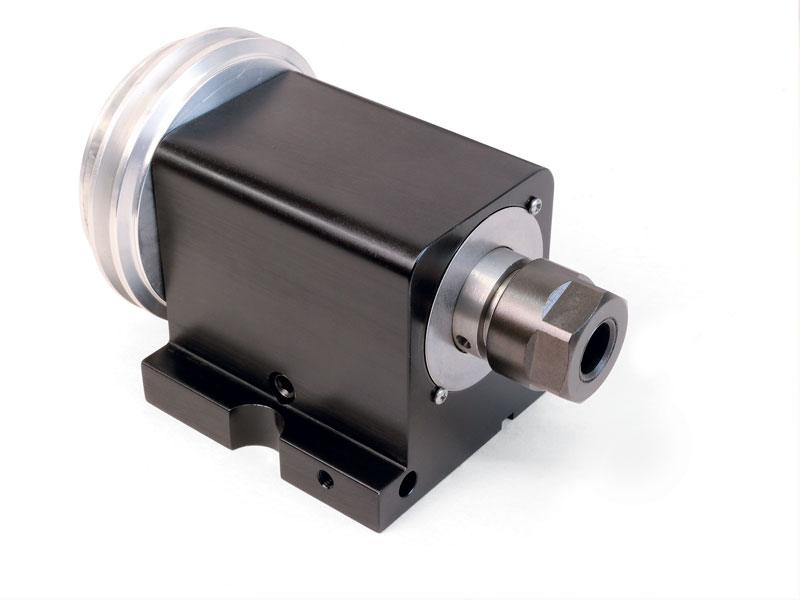

Sherline ER-16 Spindle Headstocks
The ER-16 collet nut is included.
About Sherline’s ER-16 Headstock
It is for use on a Sherline lathe or mill in place of the standard headstock if you want an ER-16 spindle.
The ER-16 nut that ships with your order may be plain or have a black oxide finish. The headstock includes a spindle pulley and a precision ground head key.
NOTE: If the ER-16 nose is ordered, no Sherline accessories that use a #1 Morse taper or 3/4-16 thread will work on this spindle.
