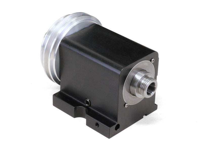

About Sherline’s Standard Headstock
Our standard headstock has a Morse #1 Taper spindle with 3/4 x 16 threads to accept 3/4 x 16 tools. The headstock includes a spindle pulley and a precision ground head key.

How to Distinguish between Standard Spindles and Coated Spindles
There is a subtle change in the color of the coated spindle, but in the absence of comparing them side by side, the most evident way to tell whether you have a coated spindle is to check for the witness mark. There is a machined groove on the shoulder of the spindle where you would insert a Tommy bar. We add this groove at the factory so we know which spindles to send out for the plating process. (See Figure 1. Click on the photo to view a larger image).
