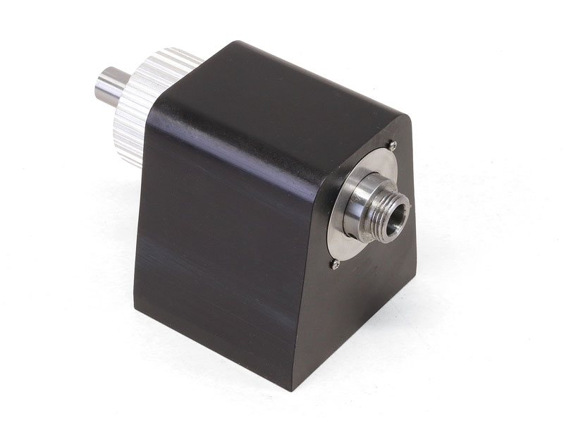

About the Tapered Headstock w/Flat Base
The Sherline industrial headstocks were developed based on the headstock used on the Sherline lathe and milling machine. The headstocks are made from extruded 6061-T6 aluminum and have a black anodized finish. They are available with your choice of a spindle (3/4-16 #1M taper or an ER-16*) and pulley configuration (a standard 2-step “V” belt pulley or a 30-tooth cog belt pulley).
Standard Features
  • Two 1/4-20 mounting holes and an alignment key slot on the bottom of the base
Mounting the Headstock
The flat bottom headstocks have mounting holes and a keyway. The two 1/4-20 mounting holes provided in the bottom of the headstock are for mounting to your fixture or machine. A 3/16″ wide x .110″ deep slot is provided should you wish to use a 3/16″ alignment key (sold separately) to aid in precisely locating your headstock.
Optional Nickel/Teflon Spindles
Most of our spindles are available with a Nickle/Teflon plating as a rustproof option for an additional cost. Check the option box above to add the Nickel/Teflon plating to your spindle order.
Spindle Precautions
Download PDF Tapered Headstock w/Flat Base Instructions
Spindle base size3.0″ long x 3.36″ wide (76.2 mm x 85.4 mm)
Spindle case height3.66″ (93.1 mm)
Spindle centerline height above table2.50″ (63.5 mm)
Spindle nose thread (Models 6501, 6502)3/4-16
Spindle nose internal taper (Models 6501, 6502)#1 Morse
Spindle nose thread and taper (Models 6503, 6504)ER-16
Bearings(2) 20 mm, class 5, lifetime lubricated ball bearings with adjustable preload
Runout at spindle nose0.001″ (Most are within .0005″)
End play (factory preload adjustment).0002″ (.0051 mm)
Recommended continuous spindle speed4000 RPM or less
Maximum spindle speed10,000 RPM
Mounting provision2 holes, 1/4-20, 2″ (50.8 mm) between centers on part centerline
Alignment provision3/16″ x .10″ slot between mounting holes on spindle centerline for 3/16″ alignment key
